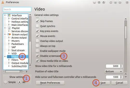

  1. Open VLC's preferences.
  2. Select All in Show settings at the bottom of the window.
  3. Pick the Video section at the vertical tree.
  4. Tick the Disable screensaver checkbox.
  5. Save settings.

There are couple of settings that you should check in VLC:
1) Tools --> Preferences --> Show All --> Video --> Disable screensaver
2) Tools --> Preferences --> Show All --> Advanced --> Inhibit the power management daemon during playback
