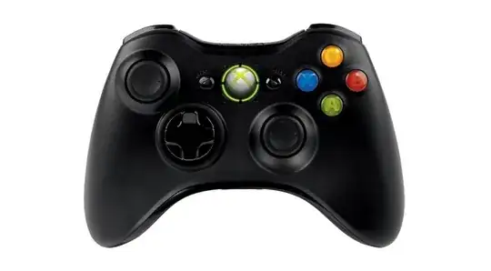

I've connected a XBox Wireless Controller for PC with my ubuntu machine. Everything works fine and all js0-3 devices in /dev/input/ are available.
But normally the circle in the middle of the controller should show the device id (1-4), which isn't shown. The circle is only blinking. I tryed that in Windows and everything works fine. Also the wired XBox Controller has no problems to show its id.
Anybody know, why this doesn't work? Are there some kernel modules, which must be enabled?
Xbox Controller
