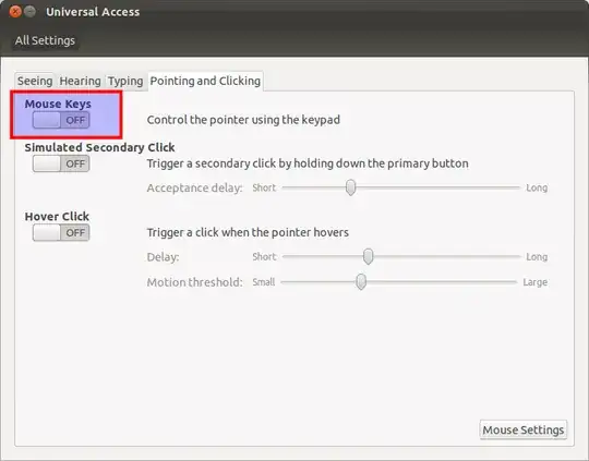

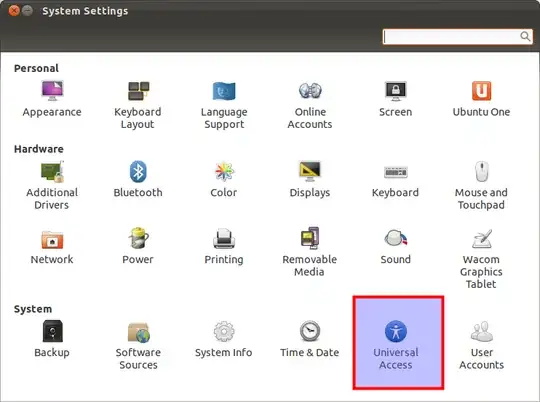

In 11.10 and above you go to System Settings in the Power cog menu and select Universal Access.
Under the Pointing and clicking tab you will see a slider that lets you turn Mouse Keys on and off. The label says: Control the pointer using the keypad.

  1. Click the icon at the very right of the menu bar and select System Settings.
  2. Click Universal Access.
  3. Select the Pointing and Clicking tab.
  4. Switch Mouse Keys on.
  5. Make sure that Num Lock is turned off. You will now be able to move the mouse pointer using the keypad.
