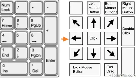

The image below shows how to control your cursor: enter image description here
Source: https://www.repairwin.com/wp-content/uploads/2019/03/image-8.png
