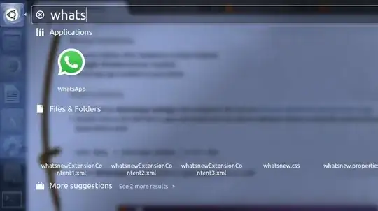

  • Select WhatsApp from your Dash or Applications menu to start.

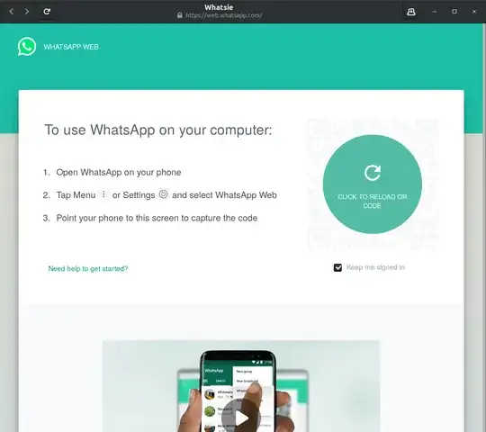

  1. Open Gnome Web and go to https://web.whatsapp.com
  2. Select 'Install Site as Web Application' from the burger menu
  3. Name the app as you like e.g. WhatsAppWeb or Whatsie
I recommend to log out from all devices, then open the created desktop app.
  1. Finally scan the QR code.
