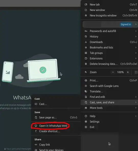

I found out this question from some years ago. Now there is a easier way to do it.
  1. First install Chrome by the method or option that you prefer. Here's a link for with suggestions for the current stable 24.04
  2. With Chrome installed go to the WhatsApp webpage, login with your phone and QR.
  3. In that tab, just go to Chrome's option menu on the right corner (the three vertical dots), then click on "Cast, save, and share" and click on install WhatsApp web. Now there is no need to the create shortcut and set the way to open it as a window.
Disclaimer: In the image I've shared, it says Open in WhatsApp Web, but if you didn't install it yet, it will say Install WhatsApp.
