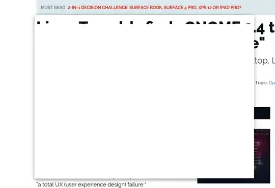

I dont know exactly what happened. When I open my terminal window, it completely cracked. I dont anything editing this window. How to i reinstall gnome-terminal ?
I have tried the below post's solutions, How to reinstall Terminal?
But, it didn't solve my problem.
It would be great, if give any solutions.
Thanks.
