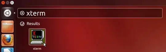

Press Alt+F2, type xterm, and press Enter.
Typing xterm into Unity. (This is the Alt+F2 menu, but typing into the normal dash is usually as effective.)

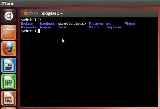

xterm (running on Unity 2D in Ubuntu 12.10 Precise Pangolin, but regardless of version and UI, it will look similar).
Ubuntu's xterm is very basic in style. As far as I know, there's no GUI way for xterm to scroll back, save history, change font and font size, or anything like that. The actual shell's capabilities will of course be the same as in any Terminal, since it's still bash. (Or whatever you set it to be.)
