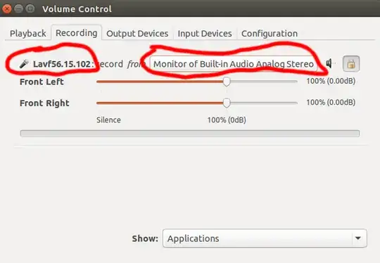

pavucontrol
  1. Install pavucontrol.
  2. Start recording with ffmpeg (see example commands below).
  3. Start pavucontrol.
  4. Go to the Recording tab and you'll find ffmpeg or Lavf56.15.102 (or similar) listed there.
  5. Change audio capture from Internal Audio Analog Stereo to Monitor of Internal Audio Analog Stereo.
Now it should record system and application audio instead of the microphone.
This setting will be remembered. The next time you want to capture with ffmpeg, it will automatically start recording system audio. If you want to revert this, use pavucontrol again to change back to microphone input.
The text above was adapted from HOWTO: Screencasting on Linux.
