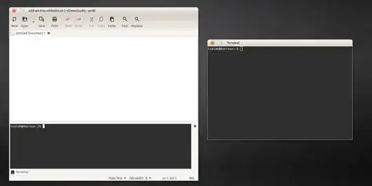

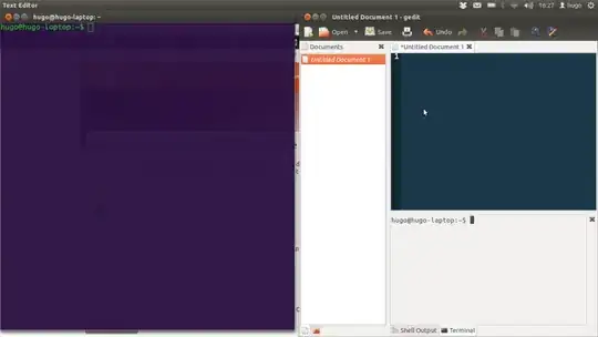

I've just updated to 11.10 and now my embedded terminal in gedit does not match my default terminal. I hate looking at a white and black terminal. Does anyone know how to make the embedded terminal match the default terminal?
This is a screenshot:
Screenshot
I want my embedded terminal in gedit to match my default terminal.

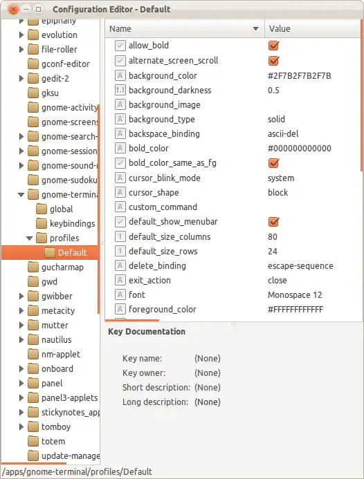

  2. Open up gconf-editor and navigate to apps ➜ gnome-terminal and select a profile:

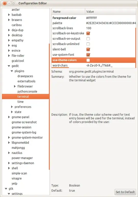

  3. Now open up dconf-editor and navigate to org ➜ gnome ➜ gedit ➜ plugins ➜ terminal and uncheck the use-theme-colors key:
  4. From gconf-editor, copy the values of the
    • background-color
    • foreground-color
    • palette
    over to the corresponding keys in dconf-editor. The embedded terminal should now match a regular gnome-terminal.

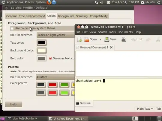

Make sure you haven't ticked Use colors from system theme then it should work:

Open gconf-editor and go to apps->gnome-terminal->profiles->Default
  • Uncheck the use-theme-colors option.
  • Set foreground color: #FFFFFF
  • Set background color: #000000
This will set the text to white and the background to black. It will set this for both the terminal and embedded terminal, if you would like to use different colors for each, then do this instead.
