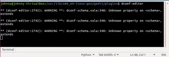

I tried changing the settings using dconf-editor but the changes are not reflected in gedit

The issue lies here, in /usr/lib/x86_64-linux-gnu/gedit/plugins/terminal.py lines 88-98:
def get_profile_settings(self):
profiles = self.settings_try_new("org.gnome.Terminal.ProfilesList")
if profiles:
    default_path = "/org/gnome/terminal/legacy/profiles:/:" + profiles.get_string("default") + "/"
    settings = Gio.Settings.new_with_path("org.gnome.Terminal.Legacy.Profile",
                                          default_path)
else:
    settings = Gio.Settings.new("org.gnome.gedit.plugins.terminal")
return settings
When the plugin gets the terminal settings, it first checks the dconf-editor path for the default terminal settings, which, if yours is like mine, only has the use-theme-transparency setting. As a result, the embedded terminal has no settings to actually use. I figure the hard way to fix this would be to replicate the keys in org.gnome.gedit.plugins.terminal into the org.gnome.Terminal.ProfileList. Instead, open terminal.py, comment out the if statement, and force the settings to use the org.gnome.gedit.plugins.terminal settings.
