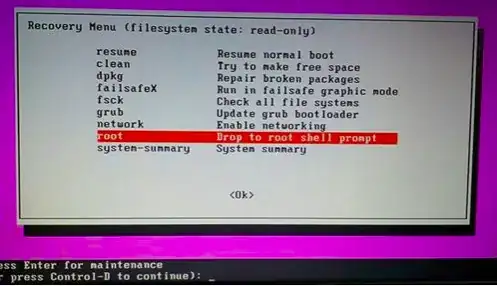

To fix this I tried to follow this: Cannot run any sudo command
The Simple fix one did not work, so I tried the complex fix one, rebooting in recovery mode. Got to this step:
recovery menu
bit I could not enter the whole command of
mount -o remount,rw /
chmod chmod u=rwxs,g=rx,o=rx /usr/bin/sudo /usr/bin/pkexec
exit
before I could complete /usr/bin/sudo, it started to run commands on its own and resumed. So, here I am, not understanding anything. Can anybody help me ?

You are executing these commands from a root shell prompt, so you don't need to preface the commands with sudo and you don't need to run sudo -i at all because you are already root.
The command in this answer is incorrect because chmod is repeated twice:
The correct command is:
