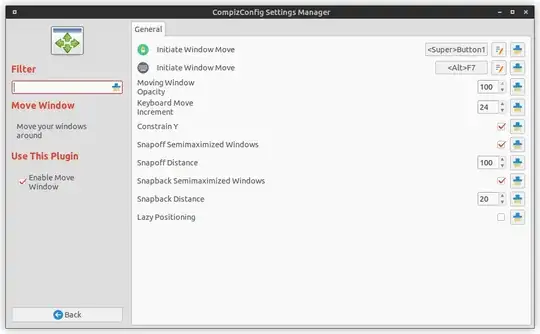

It’s a Compiz plugin.
Install Compiz Config Settings Manager (sudo apt-get install compizconfig-settings-manager in a terminal) and open it.
Once opened, search for a “Move Window” plugin. Select it, and disable or change the first option, “Initiate Window Move”.

With regard to Fitoschido's answer:
Clicking on the <Alt>Button1 and just disabling it didn't work for me - it had no effect (and when restarting the computer, is was enabled again!). (I'm on Ubuntu 13.10)
What worked was clicking on the <Alt>Button1 and setting it to a different combination, for example ALT-SUPER button1.
This worked fine for me on Ubuntu 15.10 (command in terminal):
dconf write /org/gnome/desktop/wm/preferences/mouse-button-modifier '"<SUPER>"'
This changes Mouse+Tab combination to Mouse+Super.
