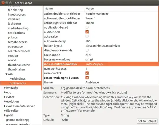

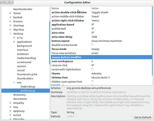

First of all, install dconf-tools Install dconf-tools.
To do that, run the following command:
sudo apt-get install dconf-tools
Then open it, Alt+F2dconf-editor.
Scroll down to orggnomedesktopwmpreferencesmouse-button-modifier → Set it to whichever key you like.
Or, equivalently,
gsettings set org.gnome.desktop.wm.preferences mouse-button-modifier "<Super>"
in the terminal. (This requires neither dconf-editor, nor dconf-tools Install dconf-tools)
Warning: Setting it to nothing means that all clicks move windows, instead of disabling it!

In UBUNTU 14.04 LTS use in dconf syntax like
<Alt><Super>
Works well for me.
BTW: If you set something wrong, it starts to move window on every click. Use to navigate to "Set to Default" button. And hit .
