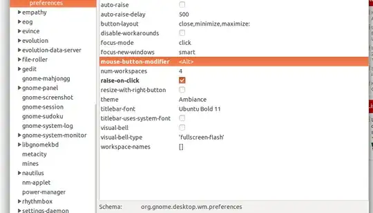

In 14.04 (or 14.10, 15.04, 15.10, 16.04), to set the default key / value:
dconf write /org/gnome/desktop/wm/preferences/mouse-button-modifier  '"<Alt>"'
You can give it a (limited number of) other value(s), but DON'T set it to none like you could in the past. Nor should you set it to an empty string, Doing either will give you some trouble getting control over your mouse back, as I found out...
The practical value of this information is quite limited, since not many alternative keys are accepted. I found only Shift and Super to be working, which I doubt will give you the solution you'd like to have.
Of course you can use dconf-editor as well:
org>gnome>desktop>wm>preferences

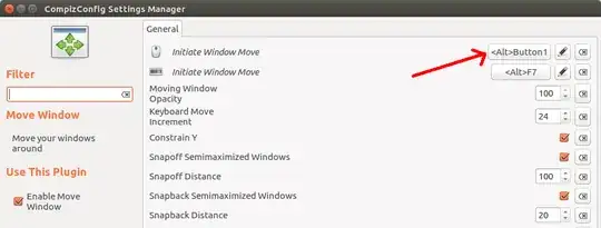

You can also do this through Compiz Settings Manager.
Just install it with sudo apt-get install compizconfig-settings-manager.
The addon is called 'Move' and is located in section called 'Window Management' I believe. You can go straight to its settings with ccsm -p move.
I really recommend this application. It gives access to massive amount of system customization options.

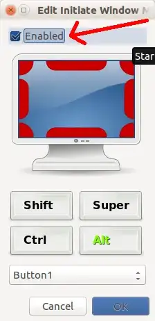

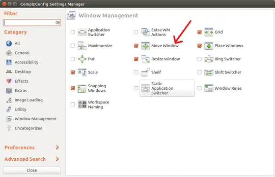

You can us CompizConfig Settings Manager (CCSM). This tool is essential if you want to tweak Linux for better efficiency, because it makes it easy to configure the desktop environment to be much more efficient then out-of-the-box Ubuntu. I used to use things like dconf-editor, and Ubuntu Tweak, but for tweaking anything related to desktop behavior, I have found CCSM to be much more powerful and easy to use.
  1. Install CompizConfig Settings Manager by typing this in a terminal:
    sudo apt install compizconfig-settings-manager compiz-plugins compiz-plugins-extra
  2. Open CCSM (CompizConfig Settings Manager), go to the Window Management section, and find the Move Windows icon.
  3. Make sure Move Window is enabled, and then Click it's button.
  1. Click the button to the right of the Initiate Move Window with the mouse icon next to it.
  1. In the Edit Initiate Window Move window, and then make sure to un-check the Enabled check-box. That will disable it. You can also easily set the Window Move to a different mouse/keyboard/screen-edge combination, if you would like, although binding it to a screen edge wouldn't work. This is where this tool, CCSM, outdoes dconf-editor and Ubuntu Tweak.

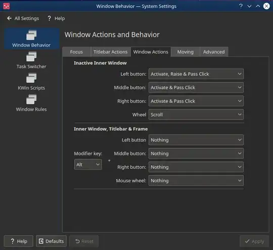

If you are using KDE Plasma then you can use System Settings.
  1. Search for System Settings in the Application Launcher or run systemsettings
  2. Click Window Management under the Workspace section
  3. On the left select Window Behavior and go to the third tab labeled Window Actions.
  4. The second section is labeled Inner Window, Titlebar & Frame. You can change any of these drop-down menus to 'Nothing' to disable their action.
Window Actions Menu
