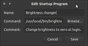

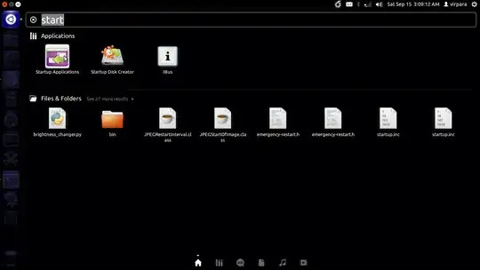

Open Startup Applications,
Click Add,
Give path as /usr/local/bin/brightness_changer.py in command and Save it.
Now whenever you login, brightness will be set to 70.
