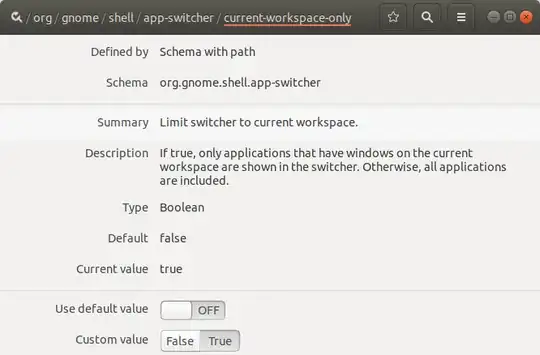

Here is the solution I came up with:
Very fast & easy, without any installations/extensions:
  1. Install dconf-editor (already installed on current debian/ubuntu distributions):
    sudo apt-get install dconf-editor
  2. Open dconf-editor (from the Dash or a Terminal)
  3. Navigate to: org -> gnome -> shell -> app-switcher
  4. Set "current-workspace-only" to true
    screenshot
..and you're done :)

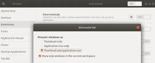

AlternateTab
If you also want to ungroup applications on switcher you can add the officially supported AlternateTab extension.
screenshot
Moreover:
Actually, Ubuntu is going to have the Alternatetab as default on Alt+tab in the upcoming version of Ubuntu (19.04), while the current default app switcher will remain on Super+tab.
