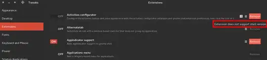

Now before I had GNOME 3.18 I used the GNOME Shell extension described in this answer to configure and customize what I have talked about. However this is what I noticed today:

It would be possible to change the supported version as described in your linked answer, but that's not necessary, because GNOME 3.18 is supported. Usually you should see an Update button in the tweak tool. I have no idea, why not in this case.
But you could also use this link to deactivate and activate/update the Activities Configurator.
Or the hard way
rm -r ~/.local/share/gnome-shell/extensions/activities-config@nls1729/
and install the extension again. To do that, open this link in your Firefox and activate the extension.
Close and open the tweak tool to see the updated extension.
