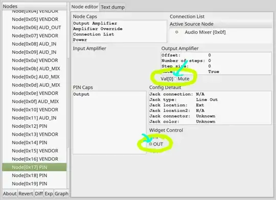

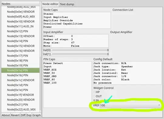

This is what worked for me:
first, install and run HDA Analyzer:
wget -O run.py http://www.alsa-project.org/hda-analyzer.py
sudo python run.py (root is required)
second, using the gui do this:
•PIN 0x17 -> Widget Control -> Check OUT and Uncheck Mute:
•PIN 0x1a -> VREF -> Set it to 100:
And third, test it by listening to some music.

Changes to node 0x17:
Untick Val[0]: Mute
Tick Out under Widget Control.
Changes to node 0x1a
Set VREF under Widget control to 100 instead of hiz.
Quit hda_analyzer.
