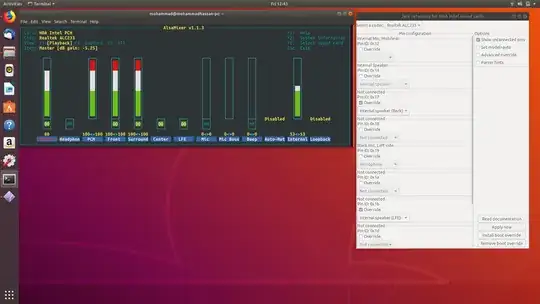

What information I have collected from HDAJackRetask:
- LFE and surround are two new settings which i did not have before. The problem is however, that they don't seem to do anything, I can't even adjust the LFE as it has no slider and the surround adjustment does no effect at all.
- In the screenshot there is also the pin
"0x14"which is the internal speaker. If I override that to"Internal speaker (LFE)"or"Internal speaker (Back)"I will suddenly get a lot more sound profiles in the Ubuntu settings, 2.1, 4.0, 5.0, 5.1 etc. but no matter what I choose it will result in no sound at all, so I stopped overriding that. - With the HDAJackRetask configuration above, I get two profiles in the
Ubuntu sound settings. One called
"Analog Stereo Output"(which is my standard) and"Analog Surroind 4.0 Output". Both works. - After reading several posts about this problem and tracking the bug
on launchpad, it seems that
0x17is the subwoofer, but turning it on still does nothing.
