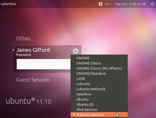

At some point during the install, you will be asked to choose between gdm and lightdm - I prefer lightdm, so thats what the screenshot shows.
Logout, you will be confronted by the LightDM manager.
Then, click the little cog wheel, and select Xubuntu Session.
Then, enter your password, hit Enter and you'll be logged into Xubuntu.
