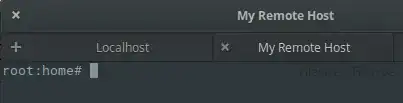

This worked in my Elementary S.O :
PS1='\u:\W\$ '
PROMPT_COMMAND='echo -en "\033]0;New terminal title\a"'
I execute this in each new tab :
tab 1
tab 2
And as the previous image shows, I have several tabs with unique name.
