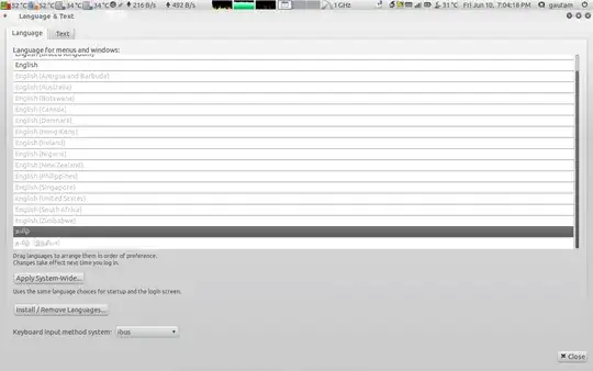

I would like to type a non-Latin script (Tamil) in Ubuntu 10.10.

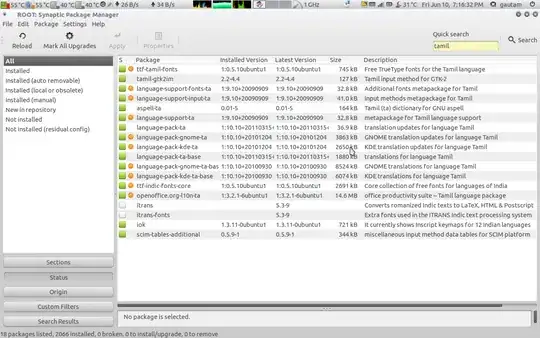

I have installed iBUS, added all the Tamil packages in synaptic, and installed Tamil in Languages support and I still can't get it to work.
Any suggestions?
iBus preferences dialog
Language and Text settings dialog showing iBus selected as input method
Synaptic showing Tamil packages
