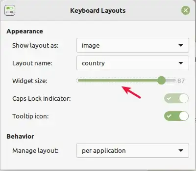

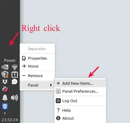

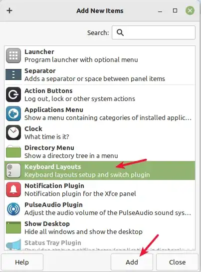

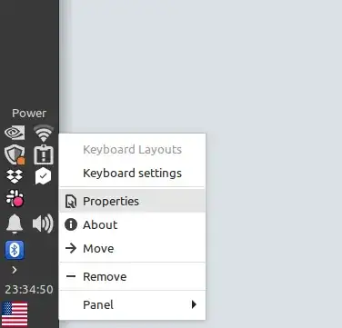

In my case I've needed to add Keyboard Layouts. enter image description here enter image description here enter image description here enter image description here enter image description here
  • For setup keyboard layout, go to Settings > Keyboard > Add Layout
  • For language indication, go to Panel > Add New Items > Keyboard Layouts
