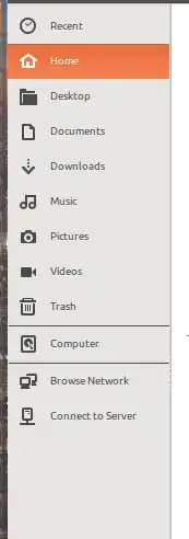

I installed Elementary OS Desktop on Ubuntu 14.04, and after that I removed it, but it's not completely removed.
I have changes in Unity, for example:
