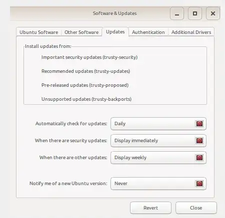

I install Elementary-Desktop on Ubuntu 14.04, after install and work with that, I don't like Elementary-Desktop and Delete that but Unity to Demolished. I try for built Unity (reset, reinstall) but No effect! Now, how to Delete all Desktop UI and reinstall Unity ?
This is my Unity:
