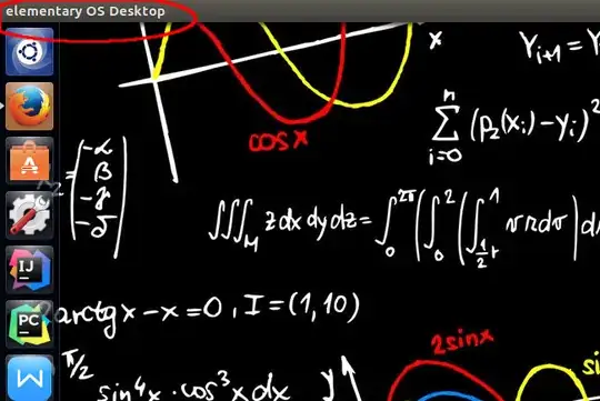

Can anyone help me remove elementary-desktop? I installed it in my Ubuntu 16.04 LTS x64 system. I already did the "solution" from this question:
How to completely remove Elementary-Desktop from Ubuntu 14.04
and also
sudo apt-get purge elementary-desktop elementary-icon-theme elementary-theme elementary-default-settings
still no luck. I also did
sudo apt-get autoclean elementary-desktop
still didn't do the job. It's still in my system, "elementary OS Desktop" is written in my bar, plus it could still be selected during login.
