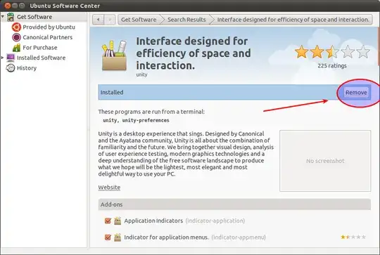

You can uninstall Unity via the Software Centre, (Applications ➜ Ubuntu Software Centre). Type unity in the search box, select Unity and then select remove (see screenshot)
You will need to select all applications associated with Unity to remove it completely.
