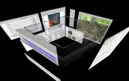

Here is the result...! A workspace using cube and 3D windows in 12.04
