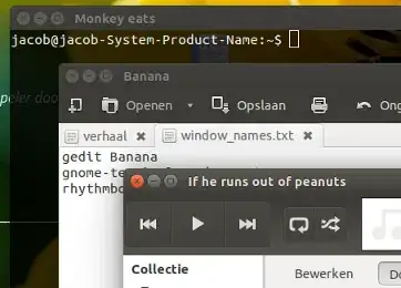

EDIT 2
Flexibly manage/set custom window names per application from a single file
In your original question, you were wondering if there was some kind of a file to set the title of new windows of a specific application. As explained, that is not the case, however, it can be created.
In the setup below, you can very easily define on a per application base how new windows are named. Simply create a file in ~ (your home directory), named window_names.txt. For each of the applications you want to set a specific windowname for, add a line of, subsequenty, the application and the desired window name:
A textfile, defining window names per application
gnome-terminal Monkey eats
gedit Banana
rhythmbox if he runs out of peanuts
Explanation
The setup exists of a simple background script. The script is very light, so it won't have any noticable effect on the performance whatsoever.
Once the script starts, it reads the file ~/window_names.txt and loads the settings per application. Then it keeps an eye on newly created windows. If a window appears that belongs to one of the applications, definied in the file, it sets the window name accordingly.
How to set up
  1. The script uses both wmctrl and xdotool:
    sudo apt-get install wmctrl
    sudo apt-get install xdotool
  2. Copy the script into an empty file save it as setwindowname.py
  3. Create the file ~/window_names.txt (exactly named window_names.txt), add your applications in the format:
    <application> <window_name>
    e.g.
    gedit Text editor
    The window name may include spaces.
  4. Test-run the script from the terminal by the command:
    python3 /path/to/setwindowname.py
  5. If all works as expected, add it to startup applications: Dash > Startup Applications > Add
    Note that in some cases, a script might break if it starts when the desktop is not fully loaded yet. If that migh be the case, the command to add to startup applications would be:
    /bin/bash -c "sleep 15&&python3 /path/to/setwindowname.py"
The script

Notes
  • If the file ~/window_names.txt is edited, the script needs to be restarted.
  • It works no matter how an application is started; it also works when applications are run from the terminal / and or with sudo.
  • It does not interefere with the the right-click option of any application.
  • The script also "maintains" the window name; if another process changes the window name afterwards (opening tabs, change directories e.g.) the script sees the window as a "new window" and maintains the window name of your choice.
