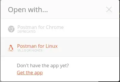

I wanted to associate postman links with my manually installed Postman app (not the chrome extension) so that I could open postman docs from the browser like this:
The link I wanted to associate looks like this:
postman://app/collections/import/39995-2b0394ab-b007-488d-9a0a...
To do the association I did the following steps:
  1. Install the app manually (download and unpack a tar.gz) in /home/andrzej.rehmann/software/postman/
  2. Create a desktop file in /usr/share/applications/Postman.desktop
[Desktop Entry]
Version=1.0
Type=Application
Name=Postman
Icon=/home/andrzej.rehmann/software/postman/app/resources/app/assets/icon.png
Exec="/home/andrzej.rehmann/software/postman/Postman" %u
Comment=Develop with pleasure!
Categories=Development;
Terminal=false
StartupWMClass=Postman
  1. Associate the postman xdg link with the application by running:
xdg-mime default Postman.desktop x-scheme-handler/postman
I've ansibled this configuration if anyone is interested: https://github.com/hoto/ansible-home-fedora/blob/fedora/roles/postman/tasks/postman_installer.yml
