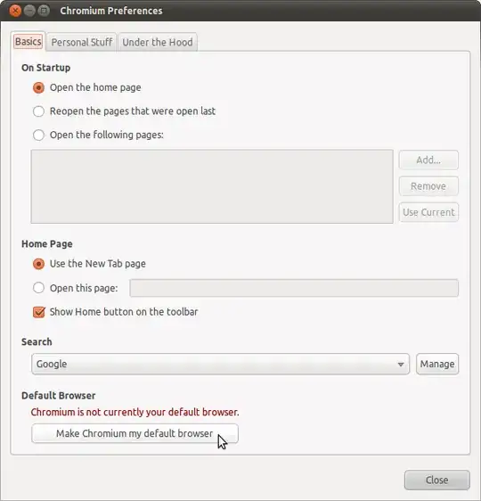

Chromium also has an option in its preferences to make it the default browser:
alt text
That should work, but it if doesn't, read on:
