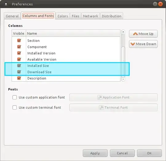

You can do this graphically in Synaptic Install synaptic.
First ensure that you enabled the Installed Size and Download size columns (or only one if you want that one).
  • To do this, go to Settings > Preferences and choose Columns and Fonts, then tick the columns you want to see.
  • Then click OK.
Preferences window

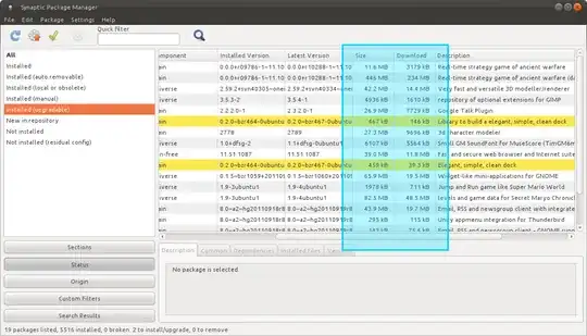

  • Once they are enabled, you can list the packages you have installed by download/installed size by click on the column.
Columns
  • Please note: I do not have my packages listed in that way this screen shot, but it works.
