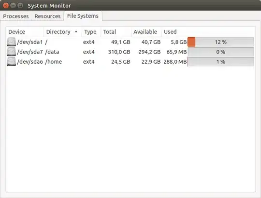

Desktop
Search in dash for "system" and choose "system monitor":

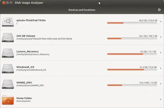

You can use the dedicated application called "Disk Usage Analyzer":
