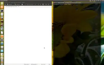

Script to call an application, wait for it to appear and position it on the screen
With the script below, you can call an application and set the position and size it should appear on with the command:
<script> <application> <x-position> <y-position> <h-size> <v-size>
An few examples:
  • To call gnome-terminal and resize its window to 50% and place it on the right half:
    <script> gnome-terminal 840 0 50 100
  • To call gedit, place its window on the left and call gnome-terminal, place it on the right (setting its v-size 46% to give it a little space between the windows):
    <script> gedit 0 0 46 100&&<script> gnome-terminal 860 0 46 100

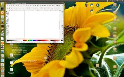

  • To call Inkscape, place its window in the left/upper quarter of the screen:
    <script> inkscape 0 0 50 50

What it does
When the script is called, it:
  1. starts up the application
  2. keeps an eye on the window list (usingwmctrl -lp)
  3. if a new window appears, it checks if the new window belongs to the called application (using ps -ef ww, comparing the pid of the window to the pid of the application)
  4. if so, it sets the size and position, according to your arguments. In case an application does not "show up" within appr. 15 seconds, the script assumes the application will not run due to an error. The script then terminates to prevent waiting for the new window infinitely.
Minor issue
In Unity, when you (re-)position and (re-)size a window with either wmctrl or xdotool, the window will always keep a small marge to the borders of your screen, unless you set it to 100%. You can see that in the image (3) above; while the inkscape window was placed on x position 0, you can still see a minor marge between the Unity Launcher and the inkscape window.
