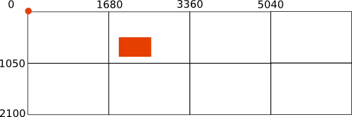

1. Understanding viewports and window coordinates
Workspaces in Unity
In Unity, unlike other window managers, you actually only have one spanning workspace, which is divided into viewports. In your case, your workspace is divided into eight viewports.
How the position of the windows is defined
The window position, as the output of the command:
wmctrl -lG
(you need to have wmctrl installed to run the command)
is described as the position, relative to the upper left corner of the current viewport:
So if you are on viewport 1:
a window on viewport 2 to could be positioned on e.g. 1700 (x-wise) x 500 (y-wise)
(my screen is 1680x1050)

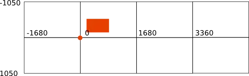

However, if you are on viewport 6:
the same window would be positioned on 20 (x), -550 (y) enter image description here
Using these coordinates correctly is important to run the script with the right arguments, as described below:
