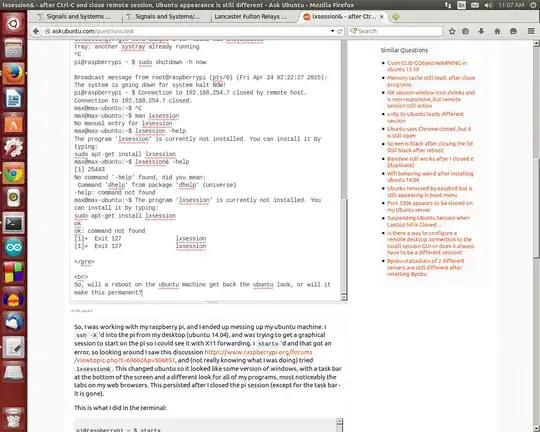

I was working with my Raspberry Pi, and I ended up messing up my Ubuntu machine. I ssh -X'd into the Pi from my Ubuntu 14.04 desktop, and was trying to get a graphical session to start on the pi so I could see it with X11 forwarding. I ran startx and that got an error, so looking around I saw this discussion on raspberrypi.org, and (not really knowing what I was doing) tried lxsession&.
This changed Ubuntu so it looked like some version of Windows, with a task bar at the bottom of the screen and a different look for all of my programs, most noticeably the tabs on my web browsers. This persisted after I closed the Pi session (except for the task bar: it is gone).
This is what I did in the terminal:

What causes this problem and how can it be fixed? Will a reboot on the Ubuntu machine get back the Ubuntu look, or will it make this permanent?
This is what my Firefox browser looks like now. Most noticeably, the tabs and scroll bars look different:
The tabs don't look like normal Ubuntu.
EDIT: I fixed it by rebooting, but I'd still be interested to know why this happens.

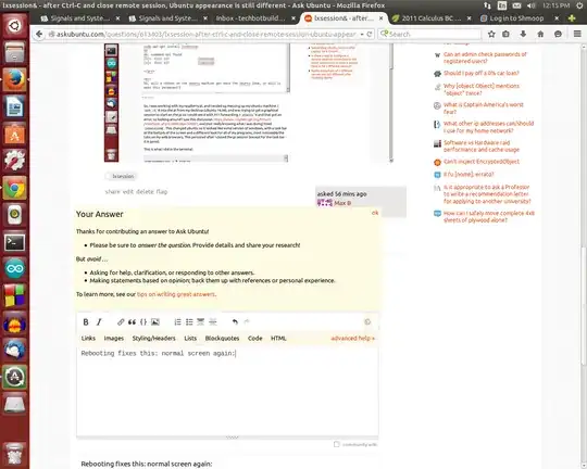

Rebooting fixes the problem, giving me a normal screen again:
fixed, normal Ubuntu look
However, when I rebooted, I was shown a giant raspberry on my desktop momentarily, as would be seen when shutting down the Pi with a GUI started. (At this point, the raspberry pi was turned off and disconnected for quite some time.)
So, if anyone has this problem, rebooting your computer will fix it.
