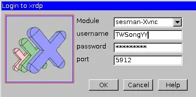

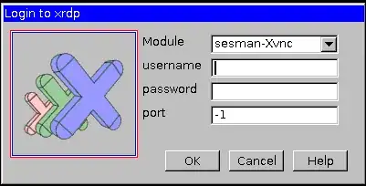

1. Modifiy you xrdp.ini:
sudo vi /etc/xrdp/xrdp.ini
2.Change the port setting port=ask-1 in your connection rule:
[xrdp1]
name=sesman-Xvnc
lib=libvnc.so
username=ask
password=ask
ip=127.0.0.1
port=ask-1
3.Restart your xrdp Service
sudo service xrdp restart
You should see the following picture when you login by remote desktop. enter image description here
1. At first login you can see this port number. Example:5912 : enter image description here
If you forget this port number, you can using the following command to check:
netstat -peant | grep 59 | grep Xvnc
2. You can re-connect the last session by your port number. enter image description here

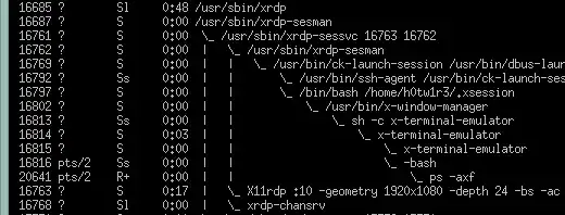

I ran into this problem on a Debian machine. Used X11RDP-o-Matic to build xrdp 0.7 packages. Prior to upgrading to systemd, xrdp session reconnect worked fine.
Looking at the process tree I could see that the sessions were no longer children of xrdp-sesman. Turned out to be a permissions issue when using systemd. Google found a patch that fixes the problem.
How do you identify a working reconnect? Run ps axf and look at the process tree for xrdp-sesman. X11rdp, xrdp-chansrv, xrdp-sessvc should all be running as a child. If they are not, xrdp-sesman will not know how to reconnect to the session.
Here's what it looks like when working:
good xrdp session process
