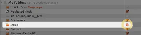

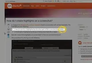

In Chipaca's answer to Managing files and sync scenarios there's a screenshot with certain highlights. The highlights are the following:
  1. A row of a GUI list is highlighted by the other parts of the screenshot being darker.
  2. A check mark is highlighted by being circled by what looks like a (orange) crayon.
How do I create both of these highlights on a screenshot? Is there an automated process?
The screenshot I'm referring to looks like this:
Ubuntu One Control Panel “Cloud Folders” tab, with a row highlighted to illustrate the point in the text
N.N.

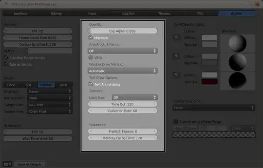

Here's a guide for The GIMP
Install GIMP

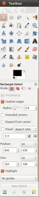

Create Highlighted Rectangle
  1. Select Rectangle Tool:
    • tick Feather Edges choose Radius e.g. 5.0 pixels for smooth borders
    • tick Highlight to highlight the selection
  2. Select area to highlight
  3. SelectNone to remove selection.
The selection is now highlighted.
Highlight effect
Note: in some versions of GIMP the highlighting may be removed as soon as we select another tool or save the image. In this case, we can proceed as follows to keep the area highlighted:
  1. Invert the selection (SelectInvert or Ctrl+i).
  2. Bucket-fill the background with black 30% opacity.

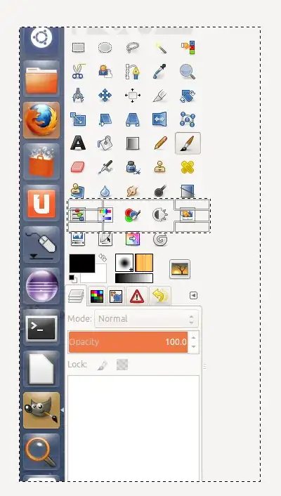

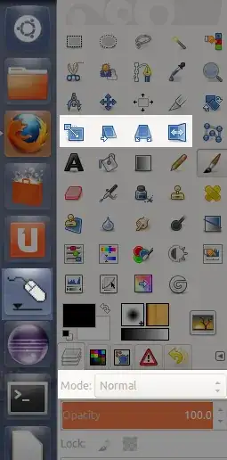

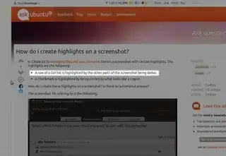

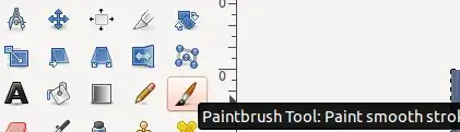

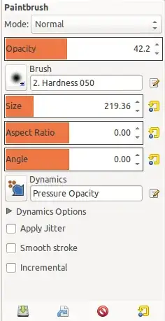

  1. Take a screenshot
    I use shutter and gnome-screenshot to take screenshot, you may use any one of them.To install them, use the commands.
    sudo apt-get install shutter
    sudo apt-get install gnome-screenshot
  2. Install gimp
    We will need this for the editing.Install it with
    sudo apt-get install gimp
  3. Get the screenshot into gimp I dragged the image into gimp.You may use file -->open
  4. The fun begins
    • We first select the part we want white.We can hold Shift to select multiple areas. Then we invert the selection using Ctrl+I enter image description here
    • Then we select the paintbrush tool. enter image description here
    • Now we change the opacity and increase size.
    • Paint everything.If it's darker, change opacity and try again.For me, 50% was fine. And the end result is.
NOTE: The options for gimp were available easily for me because I have customised it a lot. Use some gimp tutorial to learn how to use it.

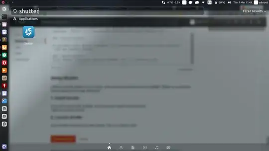

Using Shutter
I think it is actually easier to use shutter both for the screenshot and for the highlight. Shutter is an awesome GUI screenshot and image editing tool.
1. Install shutter
If you don't have shutter installed, you can quickly install it via the terminal:
sudo apt install shutter
2. Launch shutter
Launch shutter using your favourite method. This is on Ubuntu 16.04.

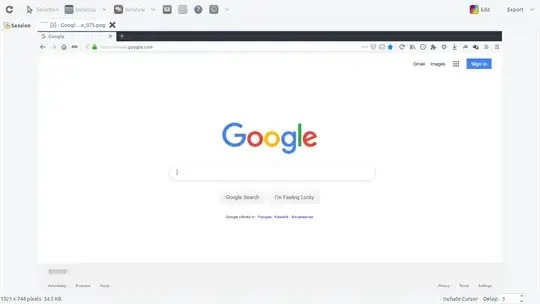

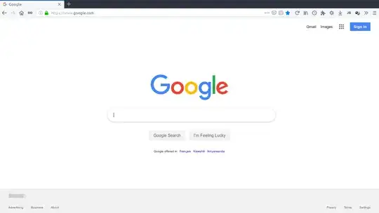

3. Take your screenshot.
Let's use google's homepage:
4. Reopen Shutter's main window
You will be greeted by a screen like this showing your last screenshot. Click on the Edit button at the top right corner.

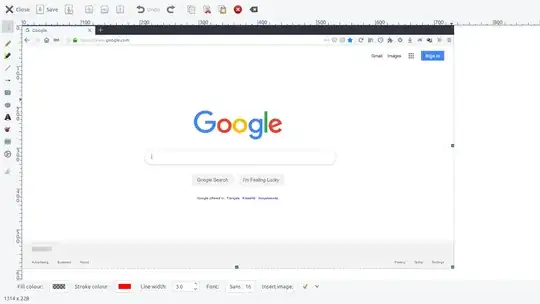

5. The edit window
This will open such a window with the edit tools and buttons on the left hand side.
Among the tools you can use include:
  • Highlight some parts of the screenshot using the Color highlighter
  • Add custom text using the Text tool
  • Add shapes like lines, arrows, rectangles, ellipses, etc
  • Censor parts of the screenshot using a smudge tool or the pixelize tool.
  • You can also crop some parts out
Edit the screenshot as required then click the save button on the top left corner to save the changes.
The screenshot below shows the effect of some of these tools:
Happy editing.

Afterwards, select something and use Filters > Light and Shadow > Highlight Area... to create a new highlight (well, shadow really) layer:
example of highlighting usage
This is also how the highlights would look with 5px of feather applied.
Feathering is optional, after all you can achieve the same effect by using the feather option of the selection tool; using layer opacity can make fiddling with the colour a bit easier, but if you want to paint on top it's easier to go with alpha fill (alternatively another layer would have to be added).
