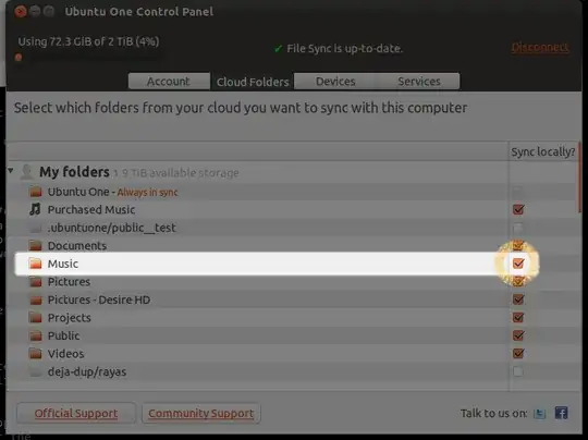

From the control panel on the computer with the small disc you tell syncdaemon to no longer sync the folder you need to empty:
Ubuntu One Control Panel “Cloud Folders” tab, with a row highlighted to illustrate the point in the text
and then you can delete the folder and/or its contents without them being removed from Ubuntu One. If later the situation changes and you decide to re-enable sync, syncdaemon will do a “merge”, which should result in any new files in that folder getting added to the sync, but no deletions.

Yes, this works, but it syncs the (old) files already on Ubuntu One with my laptop again causing it to run out of space :-)
I guess the only solutions is to have more than one Music folder then.
Ah well, it was worth a try, and this feature is actually very handy in other circumstances.
