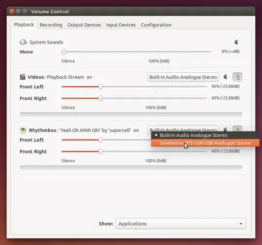

It is going to vary with hardware and my guess is that you need 2 separate sound cards or a sound card / mixer capable of such separation.
You can then configure pulseausio to send output to specific locations / cards with pavucontrol , in the playback tab
pavucontrol
One may need to install pavucontrol , either with apt-get or from the software center.
sudo apt-get install pavucontrol
