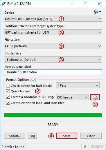

Quick search at given problem shows that either partition table is faulty or some other issue. Look at link before going into solution.
My understandings is that I am suspecting something odd about mismatching bootable media and UEFI. I know from experience that Universal USB Installer does not prepare a USB stick for booting against UEFI (It supports old BIOS) because I had a similar issue very ago in past. Windows 10 told me that system is in UEFI mode so I had to change boot mode on USB. I recommend you the same as first attempt. I also recommend using "Rufus" tool on any Windows machine and prepare "Ubuntu" against UEFI option under Rufus see image especially options 1 & 2 for help.
Otherwise, to correct the problem if partition table is involved, you may have to format the drive which is tedious.
Rufus - options 1 & 2
