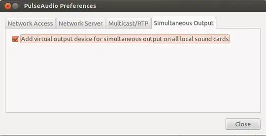

To combine output sinks we may run paprefs Install paprefs which give us an option for a "Simultaneous output device":
This combined device can also be loaded from the command line by loading the module module-combine-sink.

Duplex means the card acts as both an input and an output device for audio. It does not mean that it simply combines the output and the input into a single stream. And all the virtual output does is combine the sinks like you said, so that you can output from two separate cards at once. Neither of these accomplish what the OP, and myself, are trying to do.
