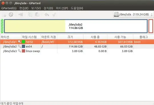

I have Ubuntu 14.04 on my laptop with GPT partition as one /dev/sda: enter image description here
Now I want to install windows 7 in a dual boot. I see this Ask-Ubuntu post How can I install Windows after I've installed Ubuntu? but using Gparted is little hard for me.
Please explain this to me, step by step using live-USB?

You seem to have not just only a GPT but also a UEFI installation. In that case there will be no overwritten MBR bootloader, which is what the link in your question is mostly about.
I'm pretty sure that machine shipped with Windows 8, so you should have followed the instructions in my answer on How to use manual partitioning during installation? and kept Windows 8.
If I wasn't entirely clear: You shouldn't be concerned about the bootloader but installing the OS you want correctly with UEFI enabled. If Windows 7 installs without flaws, do that, else get your Windows 8 Recovery or install from Windows 8 media. I heard Microsoft now offers 8.1 media for download on its website even for OEM installs (because they also don't like OEM bloatware).

  • Boot into a Ubuntu LiveUSB/CD.
  • Open Gparted and shrink your /dev/sda2/ to have enough space for the Windows installation.
  • Create NTFS storage partition if necessary.
  • Now restart and boot into a Windows installation media in UEFI mode.
Assuming that you have a UEFI based system, it would be better to install Windows to an unallocated disk partition. So the Windows installer could automate the creation of additional partitions such as EFI partition, recovery partition etc.
  • Continue and follow the Windows installer until it is finished.
  • Now boot back into a Ubuntu Live Media.
  • Chroot into your old Linux file system as follows..
Mount your Linux root. sudo mount /dev/sdaX /mnt/ (/dev/sda2 in your case)
Mount boot partition sudo mount /dev/sda1 /mnt/boot
Bind these directories, so grub can find your Windows installation.
sudo mount –bind /dev /mnt/dev
sudo mount –bind /dev/pts /mnt/dev/pts
sudo mount –bind /proc /mnt/proc
sudo mount –bind /sys /mnt/sys
Then sudo chroot /mnt
If you successfully chrooted, then..
  • Reinstall/Recover Grub
grub-install --efi-directory=/boot/efi /dev/sda
