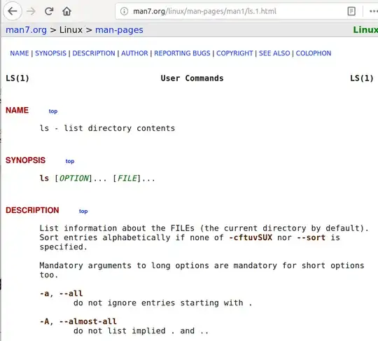

When I'm on my android phone and sometimes even when I'm on Ubuntu I will use internet to view man pages. Another benefit of internet browser is ability to easily search with Ctrl+F. In your browser search bar you can type man ls and this is the first hit:
man ls
