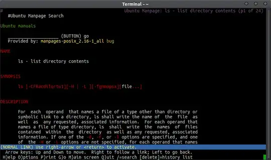

http://manpages.ubuntu.com is a great resource for viewing manpages not installed in the system. However, it uses some weird programming to redirect short URLs like http://manpages.ubuntu.com/ls.1 to http://manpages.ubuntu.com/manpages/wily/en/man1/ls.1posix.html, and it always picks the latest release. Otherwise, it works fine when using lynx with the full URL. It even looks like a normal manpage:

Using the full URL would be workable if I knew the section, which is not always the case. Is there a program which can bring up the online manpage, preferably for the running Ubuntu version? In case of matches in multiple sections, it should behave like man does.
