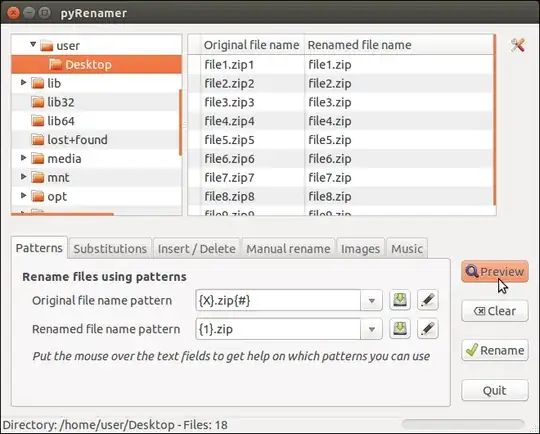

This multiple rename task is easy to do using pyRenamer from the default Ubuntu repositories in Ubuntu 16.04 and earlier. The following screenshot explains how to do it:
I know it's not the way to do it in the terminal as you requested, but this is an alternate way of doing it that you may find easier because you can browse to the files to be renamed in the pyRenamer window instead of typing the path.
In Ubuntu 18.04 and later pyRenamer has been replaced by either GPRename or the Smart File Renamer snap package (sudo snap install smart-file-renamer).
