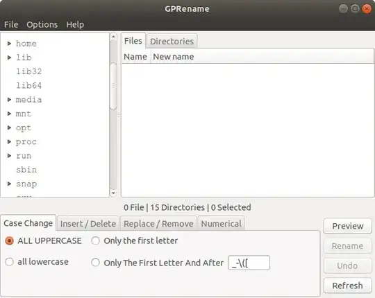

This problem can also be solved natively in 18.04 by installing another similar GUI batch renamer app from the default Ubuntu repositories. GPRename easily can replace, remove, insert, delete and number consecutively files and directories. GPRename can be installed in 18.04 and later with the following command:
sudo apt install gprename
To get the functionality of reading EXIF metadata tags in 18.04 install renrot. renrot can rename and rotate files according to EXIF tags. renrot can be installed in 18.04 and later with the following command:
sudo apt install renrot
