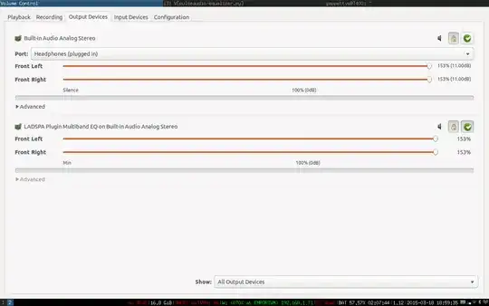

I would suggest you to try Direct Sound Processing (DSP) your audio output by using the next pieces of software:
Pulse Audio Volume Control (pavucontrol)
Install it via terminal by simply writing sudo apt-get install pavucontrol, provide your using password and allow the software to get installed, after which you can invoke it by typing pavucontrol & and hit Enter only one time.
Note: The & in the command is used for running the software and leaving the terminal available for other commands. See this: how to run more then one process through terminal
The software will allow to override the volume limit and increase it over 100% as seen in this picture of my pavucontrol in action in which I am topping the volume up to 153%
WARNING: Setting louder volume levels may harm your equipment and/or your health.

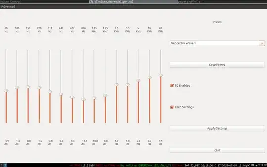

Additionally you can enrich your sound experience by using the
Pulse Audio Equalizer (GTK)
Which provides you with a full 15 Bar Equalizer with customizable Sound Presets in which you can manipulate your sound quality. After applying the equalizer configuration you can simply close the EQ in order to continue enjoying the sound quality.
You'll need to add a repository in order to install the EQ by simply writting the next commands in a terminal:
sudo add-apt-repository ppa:nilarimogard/webupd8
sudo apt-get update
sudo apt-get install pulseaudio-equalizer
Credits to @Orion in the next answer: https://askubuntu.com/a/395553/9598
When installed you can open it via Terminal by using this command pulseaudio-equalizer-gtk &
WARNING: Distortion may occur if you aren't familiar to these controls, that's why YOU SHOULD NEVER EVER use headphones nor high audio levels when manipulating a DSP EQ or any other DSP Plugin.
Remember you can open your favorite software from a Terminal or via whatever you prefer to open your software with, like Unity, Synapse, Dock, etc.
