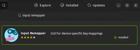

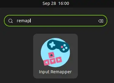

For Ubuntu 22.04, I stumbled across a related Q&A for Input Remapper.
Either:
  1. Search for Input Remapper in Ubuntu Software:
ubuntu-software-search-for-input-remapper
Or
  1. sudo apt install input-remapper
Which installs a GUI app:
ubuntu-show-apps-search-remap
It's perhaps a bit too highly configurable, though I figured out how to choose my Device (Logitech MX Master 3), click new entry, click Change Key, press the mouse wheel / Button MIDDLE, type disable, make sure the dropdown was mouse, and click Apply pretty quickly.
Toggle the Autoload to make it persist after reboot:
input-remapper-disable-middle-mouse-button
P.S. I used to use another xinput-based answer though this has completely replaced my need for it (not sure if Input Remapper is doing xinput under the hood or has truly got a Wayland version working, if so that'd be awesome!)

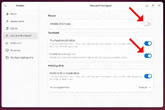

Ubuntu 24.04
You can disable it with GNOME Tweaks.
First install it if you don't have already installed. Add the necessary repository:
$ sudo add-apt-repository universe
Then install:
$ sudo apt install gnome-tweaks
Finally, open it from the GNOME launcher (or from the console with gnome-tweaks), go to the Mouse & Touchpad tab, then in Mouse Click Paste disable the toggle. Same for Disable Secondary Click toggle.
Note that this only disable the middle click from the touchpad area, but not from the physical middle button that some touchpads have above the touching area, like ThinkPad laptops.

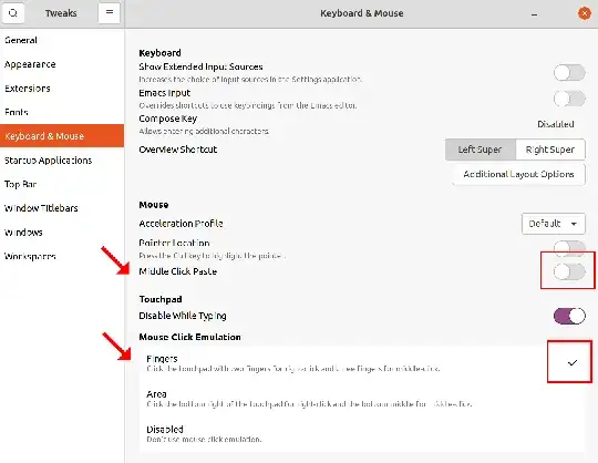

Ubuntu 20.04
GNOME Disable Middle Click
Then install:
$ sudo apt install gnome-tweak-tool
Finally, open it from the GNOME launcher (or from the console with gnome-tweaks), go to the Keyboards & Mouse tab, then in the Mouse Click Emulation section click the option Fingers. Optionally if you also want to disable the middle click for pasting in the console (at least for me is really annoying), in the same tab disable Middle Click Paste.
